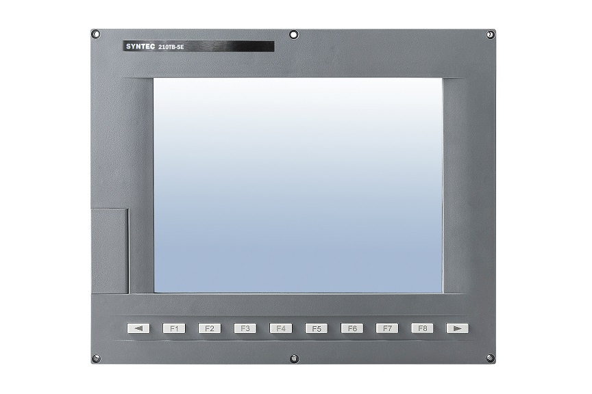

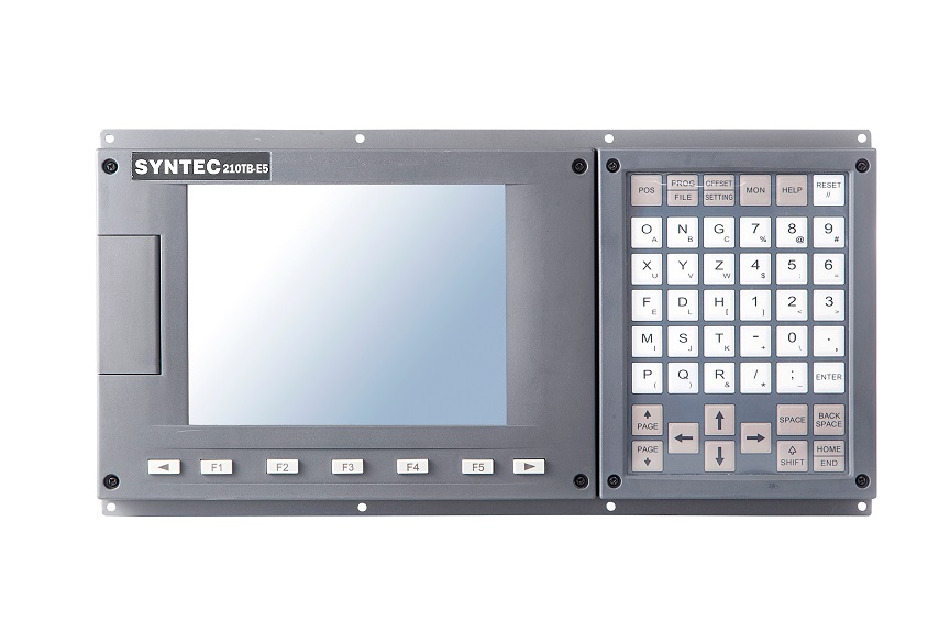

210-5Series
210TB-E5
-Support Mechatrolink III/ EtherCAt/ RTEX serial bus communication
-Support up to 4 axis group and 5-axis simultaneous machining
-Equipped with milti-program aplication
-Brand-new multi-program HMI
-Meet the demands for application of mill-turn machine
-RTCP for high precision processing on surface
New design of new generation
New design of physical appearance Open bus servo communication, support Mechatrolink 3 and Ethercat Focus on the pursuit of higher confidence level.
Provide various products for machine tools
Able to be used with servos applications Satisfy all of machining needs
Multi-program application, Satisfy combined machining need
Support for two-way, three-way and four-way applications.
Rotation Tool Center Point Feature(RTCP)
Support 3D tool length compensation feature,user only needs to program product in CAM program,controller will automatically implement tool length and wear,and the tool tip will always on the perpendicular against product contour.
210-5Series
PRODUCT
Model210TB-E5
Axis no.12(18)
RTCP
Max I/O64/64
Display10.4"
ServoM3/EtherCAT
VGA○***
ConnectionEthernet/RS485/SRI
Multi-Program No.4
RAM4GB
multi-axis linkage-
