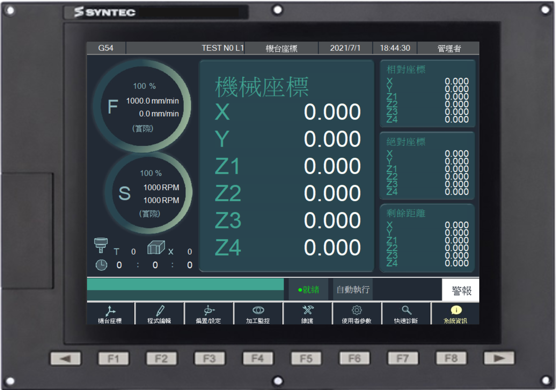

-Special function and special screen
-With high-performance main board,HSCC,and servo tool magazing
-Provide better quality for processing and more options for usages

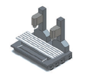

Special function and screen for glass grinding industry
-Special function and special screen for multiple z axes
