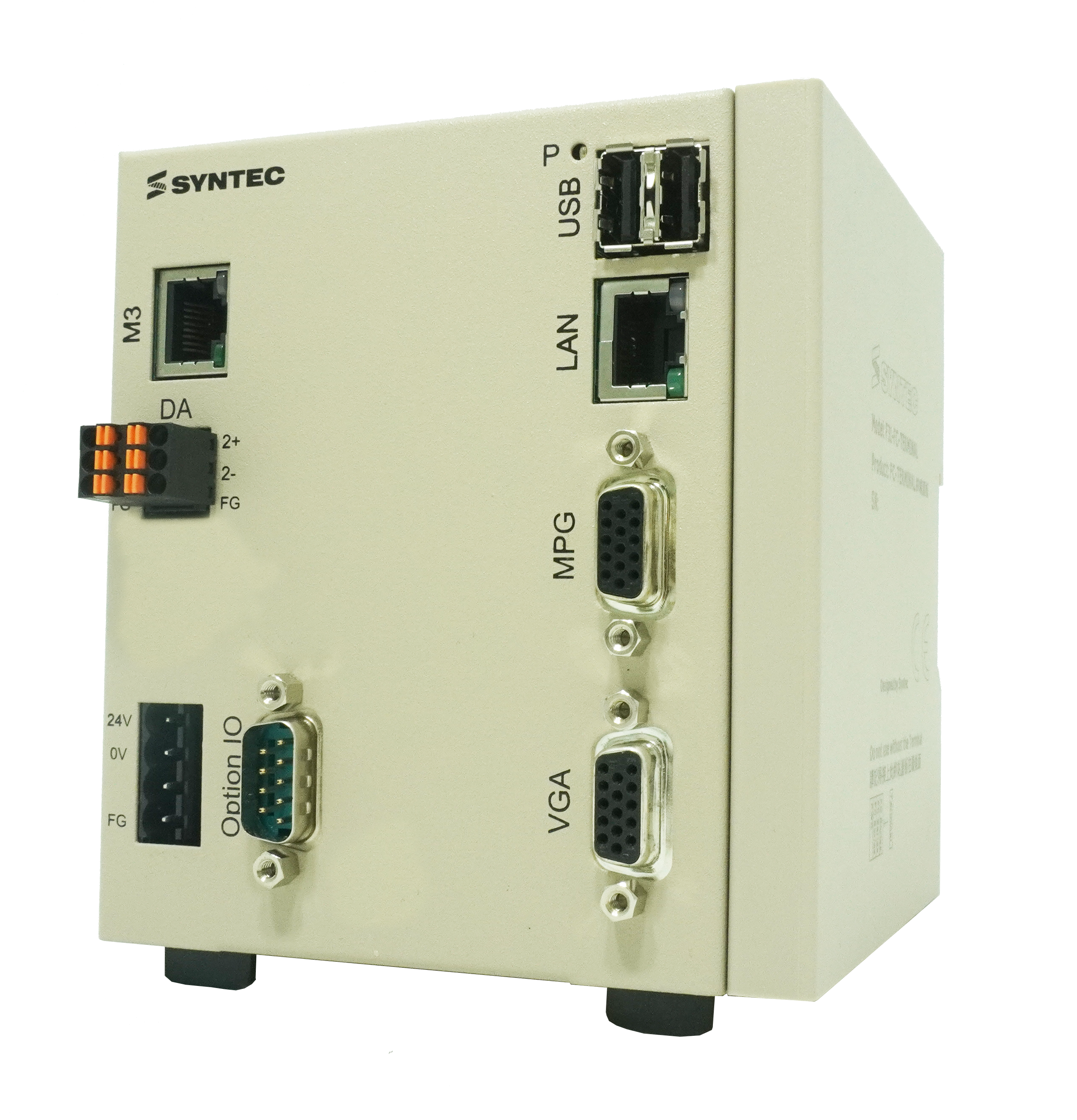

High-End Serial Laser Cutting Controller
Laser cutting serial bus controller, supports M3, EtherCAT communication, integrates laser, axial, and gap control functions, can realize high-speed-high-precision machining scenario. Integrated PLC and HMI modules, provides customization flexiblity, and can make specialized development for the industry-specific feature to upgrade the added value of machine. Built-in a variety of process parameter modules, which can satisfy machining requirement of different processes according to industry applications such as metal, wood, plastic, and etc.
High-End Serial Bus Control System
Serial Bus communication system, supports Mechatrolink-III、EtherCAT, and provides laser control and gap control modules, the highly integrated modules providing fine machining performance and stability.
Compatible with standard laser source control of major laser brands.

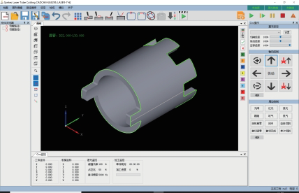

Tube Cutting CAD/CAM
Complete pipe cutting CAD/CAM function for round tube profile cutting and cut off.
- Provides drawing and editing CAD functions.
- Provide layout, manual/automatic path sequencing, 3D simulation functions.
- Provides online modeling of three-way pipe.

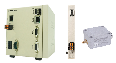

Laser Control Dedicated Controller
- Provides key functions such as high-sped gap control, fly cutting, frog leap, intelligent edge seek, auto-focus.
- Built-in process database, user can select the appropriate process parameter according to materials.
- Power-velocity modulation machining quality is improved.
- Support integrated automatic loading and unloading to improve production efficiency.

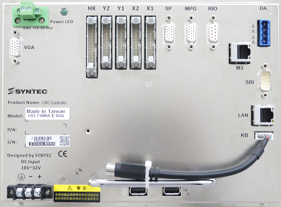

PRODUCT
Model70CB-5710CA
Standard Axis No.54
Optional Axis No.18
Servo ControlMechatrolink-III / EtherCAT
Communication ProtocolRS485, ModbusTCP, EtherNet/IP
Network10/100Mps
External InterfaceRJ-45, USB, DSUB, MPG
USB2
DisplayVGA
Max. I/O4096/4096
Input VoltageDC24V 1A
